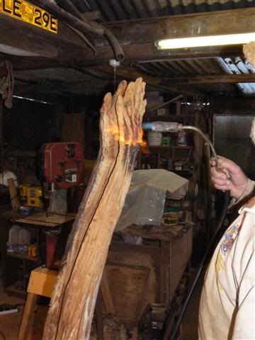

Now for the fun part,I love to work with a gas blow torch and wire brushes as the texture it leaves is unobtainable with anything else.

i bet be careful with that blow torch we want to see it finished jim

Thanks Jim and Andi.   Jenni keeps pestering me to lend her the blowtorch for finishing off her creme brulee,Maybe you could try yours out for that and get a bit of practice before you have a go on the woodturnings. Be a shame if you spoiled a woodturning.
By the way ,it wasn't a very good idea to ware the wellies while I was power carving. Good job I took them off before I got into bed. They were full to the gun'ls with shavings.

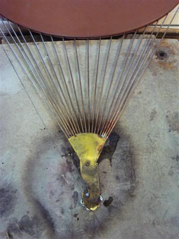

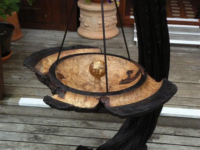

I have decided to suspend the large bowl using three rods fixed to the hands somehow. Rather than straight rods I intend to cut them into short lengths and braze them together overlapping alongside each other to form almost a lightning strike type of effect. Well I think I can see what it should look like
I will post a pic soon   Cheers    John.

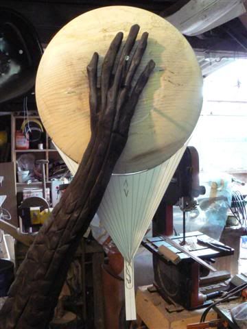

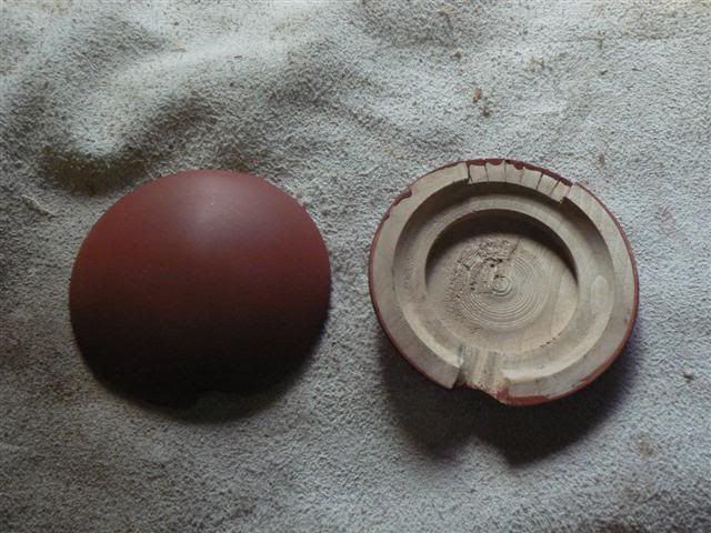

Here are a few pics of WIP. not much this week .Here is the sycamore blank in the place where it will eventually be. As it is still a bit green I have waxed the edge and will give it a bit of time to dry out before I turn it.   It just gives me an idea of the proportions I have to work to.
I have opened up the natural shakes in the lower part of the trunk prior to a bit more carving and scorching
As I have decided to suspend the large bowl from the hands area I will have to think of some way of extending the footprint of the base to give it a lot more stability. At the moment it just has the remains of it's root plate which is not too bad but not sufficient for the heavy bowl.
The root area is a bit messy and with out a definite shape or form so I shall have quite a bit of work to do with it to make it look part of the total event.   I thought of including some turned spheres of different woods and sizes into the sort of sockets where rocks were.. Possibly introduce some colour and gold leaf to add a bit of interest in this area.

Posted By: Andi
Date Posted: 02 Feb 2011 at 10:04pm
Hi John,
I love the first picture, with the contrast of the light coloured wood against the dark hands. It looks like the blank is iridescence .

Posted By: John Hodgson
Date Posted: 02 Feb 2011 at 10:33pm
It does,I dont know why it came out like that, It looks a bit like a moon made out of cheese.

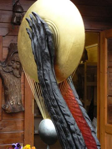

I managed to get a bit more done yesterday, mainly working down the trunk and adding a bit more to the carving. There were quite a lot of splits which I decided to open up quite a lot with the chainsaw and Proxon I have made them quite deep and some meet up towards the centre.   I am seeing the sort of ribs that are left as lines of energy rising from the depths of space up to the hands of the creator so I have accentuated these and taken them down into the root plate.
I am toying with the idea of colouring the innermost areas of the splits from red to purple to midnight blue blended into each other. I don't know whether to start with blue at the base fading to red at the top or the other way round
All the carving was by machine and followed by a good scorching and wire brushing. I keep the vacuum nozzle close to the wire brush while doing this as it creates an awful lot of soot.

Starting to open up the splits
As well as a good supply of fire extinguishers I always keep a squirty bottle of water handy. As well as butting out flames I can wet areas that I don't want to char.
Here I have carved the split down into the root area and scorched it. I have now got to refine the root plate where there is an awkward looking lump that doesn't flow into the rest of it.
I think I will saw a chunk off it.
On the right of the pic are the wire brushes I use. I find that the bronze bristle brushes work best and leave a softer smooth surface which I prefer to the coarse finish from the stiff wire brushes.
I use a fairly industrial type propane blow torch which gives a good hot flame that I need to produce this sort of work.
I am not going to go on about all the health and safety aspects related to working like this as I think anyone having a go at this work will be quite aware of the potential dangers and take the necessary precautions.
That's it for this week.   Cheers    John.

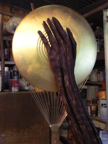

I have had another spell of work on this piece and it's good to get it a bit further on again.
I had come up with an idea for suspending the large bowl. Well ....half an idea.... the rest has yet to develop.
The first job was set our the positions and drill the holes to take the brass rods. I made a card template to check that it would work and then proceeded to coat the disc with Fontenay base to take the gold leaf. I gave it 6 coats rubbing down between each coat with wet and dry paper with a final rub down with 1200 grt.
This was my first attempt at fitting the brass rods. I was using silver solder which needed too much heat for the rods which ended up with slight bends, I was not too happy with the overall result.
so I cut the ends off the rods and started again with a slightly different method by sandwiching all the rods between 2 brass plates and using soft solder with a lot less heat.   It worked well.
The next job was to apply the gold leaf.. I was using a double weight 22 carat gold transfer leaf as I find it a bit easier to use than loose leaf. I also used an outdoor weather proof varnish type size as it is a bit more durable than the water based ones.

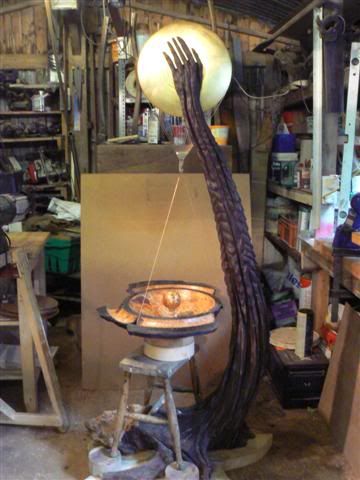

I was quite pleased with the result so I put the disc into position and just to get an idea of the effect I positioned the large bowl on a stool more or less where it will be.
As the footprint of the tree root is a little too small to be stable enough to support the heavy bowl I am making a larger area pad to fix to the underside of the root plate which should take care of the stability problem.
This is made from 2 pieces of 2" thick oak glued together with 3/4" dowels and has 2 x 1"x 2" seasoned oak strips let into the under side of the base to help keep it flat.
When the base is fixed to the root plate I will carve and scorch the top of it to blend into the root.
I will do a bit more carving and fit the base while I think of some way to hang the large bowl.
I am toying with the idea of concealing the connection between the bowl hanger and the hook with another globe type planet.This could be a hollowed out ball with the connecting hooks inside.
The bowl will have to be detachable for transportation.
As always I am eager to hear your comments.   Cheers     John.

The gold leaf really works on the disc, the rods coming down from the disc put me in mine of a suspension bridge, but also a hot air balloon.
Date Posted: 06 Sep 2011 at 4:20pm
I left off at the stage where the base had been glued up and had to be fitted to the existing root plate to give the thing more stability.
Here the base has been fitted and carved to blend in with the root plate.

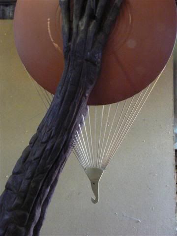

This is the brass hook that connects to the bowl suspension rods
Unfortunately I have lost the pics of setting up the bowl but it was a bit complicated.
Using a plumb line and spirit level I carefully positioned the bowl on a plank and blocks in the exact position where it was to hang.
I drilled the 3 holes in the bowl and screwed in the end of the rods that I had threaded and carefully cut them to length and positioned them to meet up with the hanging connecting piece that I made by flattening the end of a short piece of rod and making a hole in it to fit the brass hook.
All went well until I Removed the blocks. XXXXXXXXX the bowl tilted to the right more XXXXXXXXXs
I managed to solve this by drilling ten 1/2" holes horizontally into the rim and filling them with molten lead. To melt the lead I used the special melting pot that I use to cast my balls.........Not those balls!!!!!! The ones I stuff down my flintlock rifle barrel.

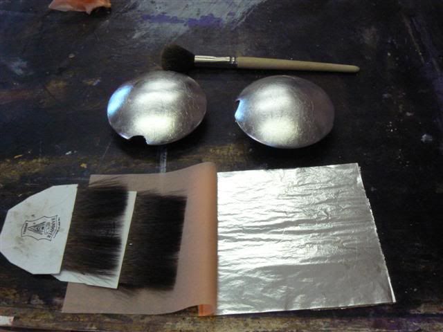

To conceal the connection I turned up two pieces of wood which I hollowed out to fit the hook.
After coating with fontenay base and silver leafing these were glued together.

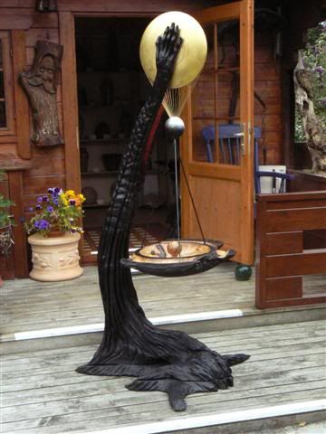

Here it is....... finished at last.
What do you mean    You can't see it.
I will post some photos shortly.
One good turn deserves another.        http://www.john-hodgson.co.uk" rel="nofollow - www.john-hodgson.co.uk
Date Posted: 06 Sep 2011 at 5:47pm

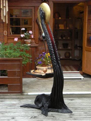

Once everything was in place I decided to colour the area between the "arms" starting at the bottom with black and going through blue purple red and orange with each colour fading into the next.
The whole piece was then coated with an acrylic varnishing wax,a product I use for coating picture frames.

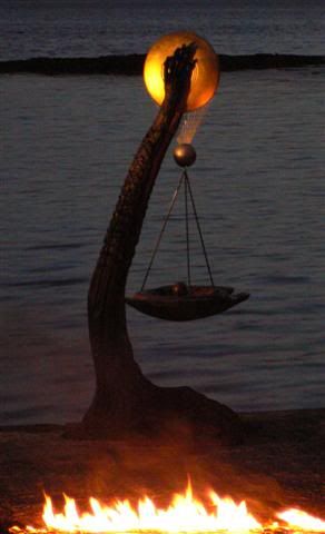

Here it is outside my wee gallery.
I also like to photograph my work in an outdoor environment.In this case on the shore of the Sound of Mull with the island of Mull in the background.
I took these shots in the late evening but we had to retreat early than hoped for as the midges got unbearable.Many of the photos were spoiled by midges in front and on the camera lens.
Oh ,,, the joys of living in the Highlands.
I started with playing with fire so I will finish with playing with fire again
By the way.... the title of this work........GENESIS..
As usual your comments are always welcome and much appreciated.     Cheers     John

Posted By: Andi
Date Posted: 13 Sep 2011 at 9:19am
Well done John
I have really enjoyed watching this piece evolve. It has become a beautiful sculpture, and you should be proud!
The photo of it on the beach, with the fire in the foreground really sets it off. I bet it looked great with the light and shadows dancing around it.
I hope the biscuit factory exhibition is successful .
