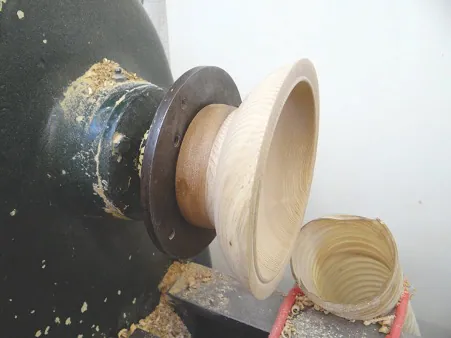

Mark Baker gets eccentric with this chuck test
Wobble Chuck in use

I like the freedom this product gives. Yes, it makes you think about what you do and how to get to the end result - a bit of juggling of position is also possible. Within two minutes of starting I was able to create an offset finial of sorts - longer experimentation has yielded a greater understanding of what can be done. This is no different to using a gouge or any other tool - more practise equals more consistent results.
