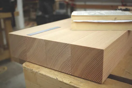

1.The joints on the top have loose tenons and are pegged

Having spent some time laying out the boards on the floor - to decide on the best balance of colour - prepare the butt joints. My planer beds are only 1200mm long, which is adequate for most things, but not a 3000mm joint. However, using a couple of support rollers it does a surprisingly good job, which I finish off by hand with a No.7 bench plane.
The joints are fitted with loose tenons into routed mortices and pegged with 6mm (1/4in) turned oak dowels. The joints are clamped up dry before gluing to check the joints. I use PVA adhesive. The better quality exterior grade products are excellent. Wetting both surfaces with glue using a brush ensures a good bond. The pegs are fitted after assembly and so serve to retain the joint rather than pulling the parts together, as with a draw peg joint.
