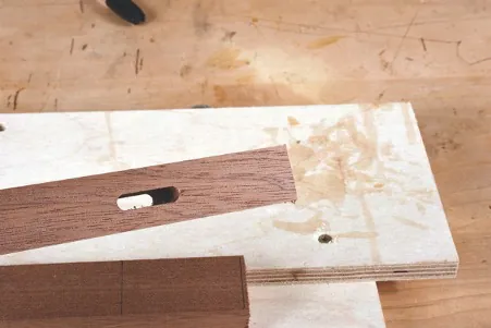

All the components of the underframe were then carefully set out using a marking knife in readiness for the cutting of the joints, which are all basic blind (stopped) mortise and tenons, apart from the kickers which locate into the front and back rails with small shouldered tenons. The mortises were cut using a Sedgwick mortiser,
The tenons were cut on the tablesaw except for the double tenons on the long stretcher rail, which was more easily done by hand. Dense, hard timbers such as rosewood, can be very unforgiving, and a mortise and tenon must be pretty well perfect to ensure a satisfactory joint. If the tenon is a fraction undersize, the fit will be sloppy with little mechanical strength, but a joint which is a touch too tight, will need excessive cramping pressure to pull up the shoulders, and runs the risk of bursting open on slender components. A tight hand-fit is ideal.
