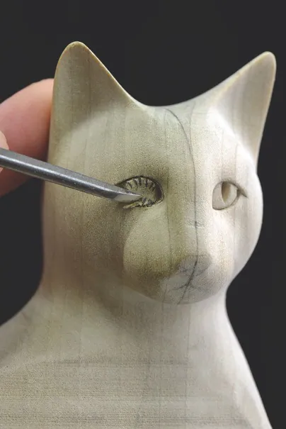

One area that concerns a lot of carvers is how to make sure the eyes remain relatively even; though few things in nature are perfectly symmetrical, uneven eyes tend to look daft. A nice simple method that works for me and can be adapted to suit most situations, is outlined below.
Carefully mark the position of one eye with a pencil, taking measurements or cues from reference material. Place the point of a mathematical compass on the centre of the top of the head, and open the compass until the pencil reaches the centre of the eye shape that you have already drawn.
Keeping the point of the compass in the same place, and the compass open at the same width, move the pencil to the other side of the head and draw an arc.
Then repeat the process with the compass point on the tip of the beak - or nose if you're not carving a bird - and draw an arc that will cross the line previously marked. The point where the two arcs cross is the centre of the second eye.
