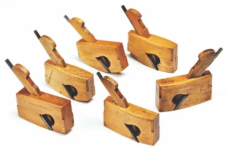

1.Scotch glue is great for restoration (PHOTOGRAPHS BY MARC FISH)

Hide glue (aka Scotch and animal glues)
While this oldest glue known to man is still used - and I have a pot ready - its uses are nearly all replicated these days by better products. Antique restorers like it because it is reversible through heat and moisture, with gap-filling properties that are ideal for damaged and sloppy tenons.
It has a very high initial tack and is better for rub joints than PVA. It was always used for veneering in the past but with the introduction of veneering presses, vacuum presses and better glues it is rarely used other than for small repairs. It is very messy, smelly and slow to prepare. It introduces too much moisture into the workpiece, so the veneer is subject to shrinkage unless it is taped perfectly. Its colour will stain the end-grain joints in veneer, resulting in a dark line on pale timbers.
The workshop needs to be warm to get any sort of reasonable results and the components benefit from being warmed either with an iron or hair dryer. Once mixed it will last in the pot for seven days.
