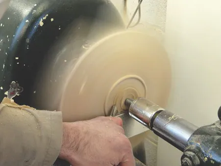

With the texturing complete, I polished it with a small cotton mop with some liquid abrasive, again using power but very gently.
There are lots of different abrasives on the market which
will give you a high gloss finish - fine abrasives similar to that
used to treat car body paint or chrome will work very well
on the various horns than can be carved.
