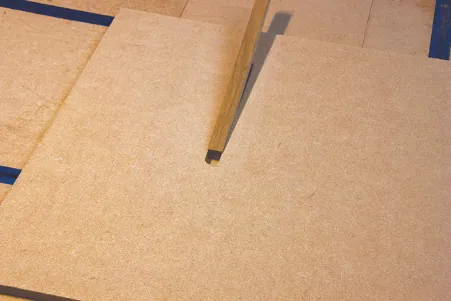

1.Peter Clothier: Safety glasses are needed not only for protecting eyes from dust but also tiny offcuts that touch the saw can whizz across the workshop
Top tips from Peter Clothier
1. A clear workspace, good lighting and safety equipment is essential. Safety glasses are needed not only for protecting eyes from dust but also tiny offcuts that touch the saw can whizz across the workshop. Ear defenders not only protect your ears but also help to keep your concentration sharp during sawing. A push stick will keep your fingers well clear of the blade.
