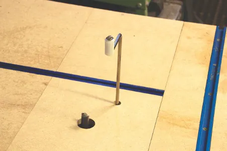

Spindle moulder, router table
Down the other side of the centre island are the spindle moulder and router table. Tooling for the moulder is expensive, so once again I have provided a wall board to keep it all together safely and highlight any omissions, along with a secure cupboard for the router cutters.
