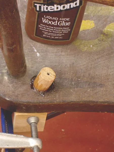

Draw up all the centrelines on the head and body sections, leave the tail to one side for now, and prepare a dowel joint for the other two sections and glue together (see photo 5).
If you are wanting to add the carving to a stick at a later date, use a jointing stud - on the final stick the stud could either be left in place or the joint could be blended into the stick for a smooth transition.
