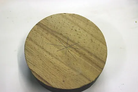

Use a mahogany bowl blank to turn the outside of the bowl. At the top of the bowl there will be a bezel and the rim will fit below this bezel
Step 6
At this point the bowl has to be the correct diameter to accommodate the plywood rim. When you approach the correct diameter take only tiny cuts to make sure that the rim fits perfectly on the hub. When you have achieved a good fit carry on shaping the bowl and finish the final shape with sanding sealer and wax. Also, turn a 100mm (4in) diameter spigot for reversing the bowl
