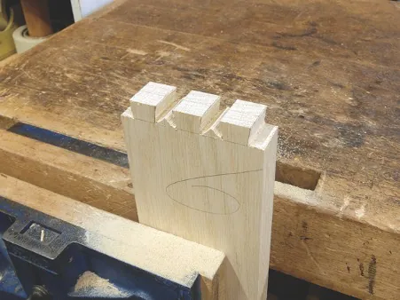

Carcass & frame joinery
Estimate joints in a carcass, frame or structure at two hours per joint. For every repetition give a discount of 5-30 per cent. Estimate hand carcass dovetailing at two hours per 300mm length with any additional part of 300mm to count as 300mm, at a minimum charge of two hours. Similarly, price hand-cut secret mitre dovetailing or secret lap dovetailing at 2.5 hours per 300mm length or part length.
Double-twisted dovetailing takes six hours for a 300mm length or part length.
Charge 2.5 hours to machine dovetail all four corners of a single large carcass - greater than 350mm - using a router and jig. Charge each additional carcass at one hour each with no discounts.
